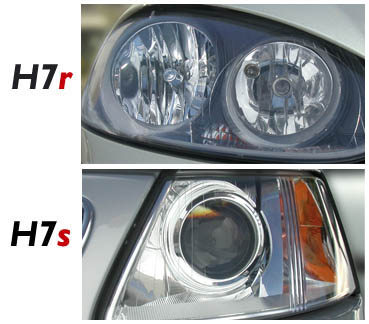

Por cierto, para el SS, hay 2 referencias en H7 NightGuide,
H7S NightGuide 12 55W PX26d
H7R NightGuide 12 55W PX26d
No sabia cual era la correcta, pero...
"H7 R or S? It depends on the type of your optics
Recent developments in ligting have led to different ways of designing lights and how they project light on to the road.
Philips created two versions of H7 NightGuide:
- H7 R for reflector systems, the most traditional beam system.
- H7 S for projector systems that have an additional optical system that directs the light."
En la foto se ve más claro, S de xxxx :lol: :lol:
